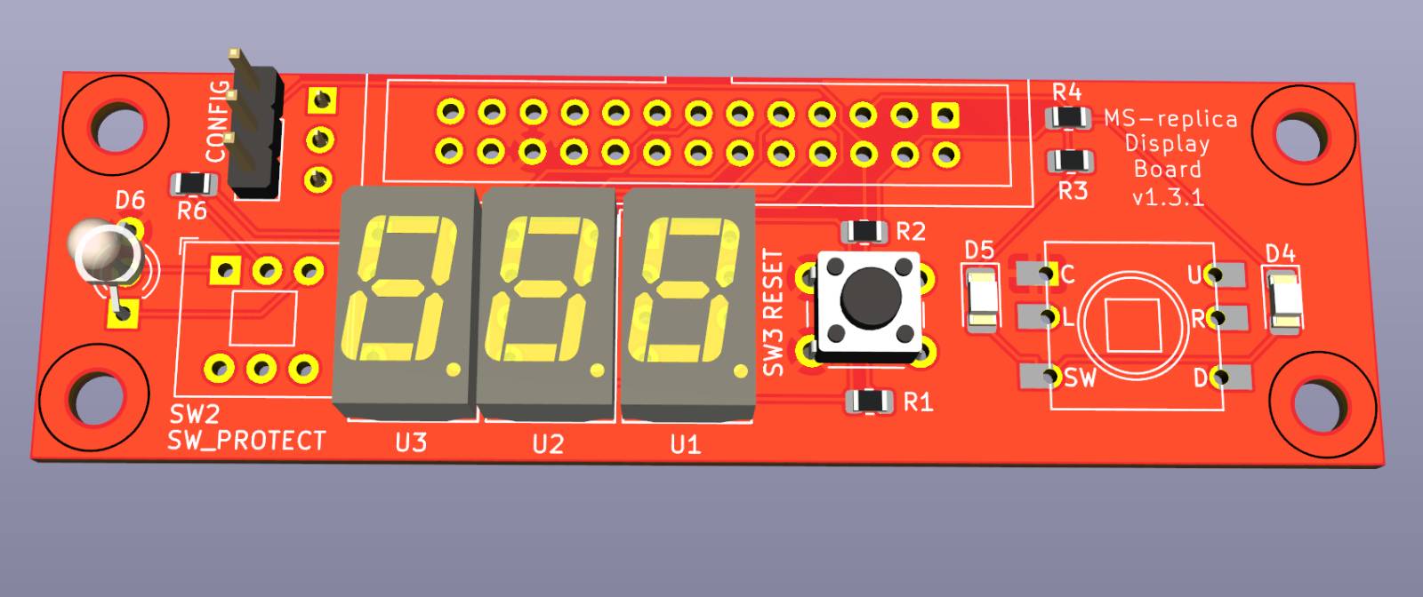

I'ld prefer a 3 digit 7-segment display. The leftmost one should replace the three density LEDs. Use the lower, middle or upper bar to show density. The dot or vertical bars could visualize the write protect state.
See my email about 7-segmet size.
Good idea! I'll propose some new variant soon :-)

I need to a while to present changes on DISPLAY module....

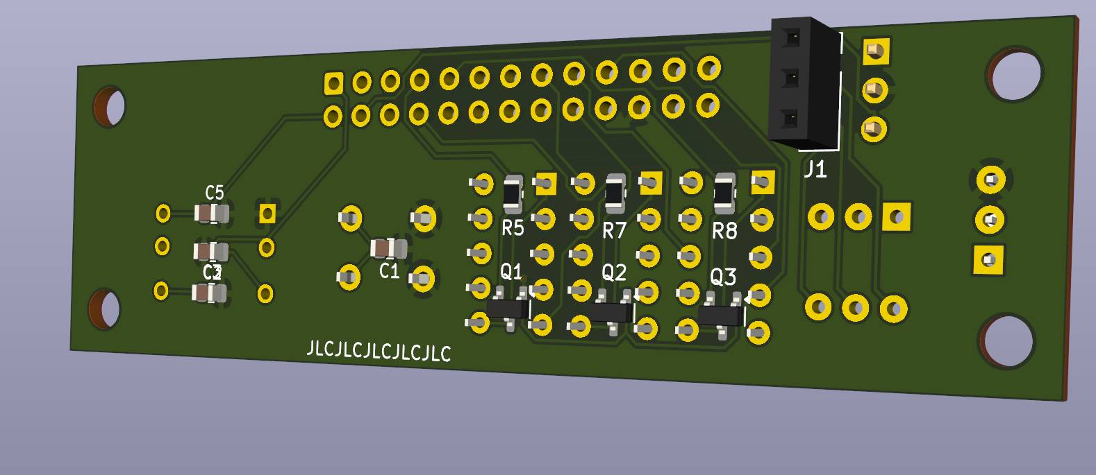

A few fresh news from MegaSpeedy Replica...
...new panel was made. This time we are using little joystick instead encoder. Additional 3 diodes were changed to additional 7-display module. It will be use to show other values than floppy density in new version.
